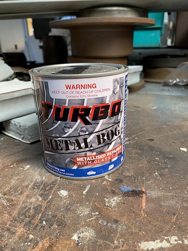

Here is my tip to fill pin holes after grinding the welds.
This stuff hardens like concrete so use carefully. I then use the angle grinder with a 80 grit disc to flatten.
I get mind from the big green shed.

Handy tip there Rog thanks, I hate chasing pin holes :crazy: :crazy:

Metal fix with fibreglass Matt works a treat

Hey Roger,
Absolutely no experience (yet) but I have read that bog absorbs moisture and that fibreglass filler is the way to go over welds. I guess as long you hit it with some paint straight away it should be fine. Downside of fibreglass filler is it's harder to work when cured. Also just reading that there is a difference between builders and auto bog.
EDIT - and now that I can see the picture of what was used ignore everything I wrote above!

Hey Scott, The metal bog that I'm using set off so hard you need to use a grinder to flatten. My research say's It’s waterproof – as in it works for boats
Builder bog I'm lead to believe is a filler that builders use to filler timber holes, is sanderable and water proof but I'm not sure if it is "suitable " for car builds.
The normal filler we all use for panel perfection is soft and if used thick can absorb moisture. Any filler I using is a very thin coat to smooth off the panel.

Sorry for the confusion Roger - the link in your post reads Builders Bog.jpg but there was no image or clickable link on my browser, just the name. I wrongly assumed builders bog. :oops:

My bad.
I need to tag my photos so I can store and then find them and attach to the post.
