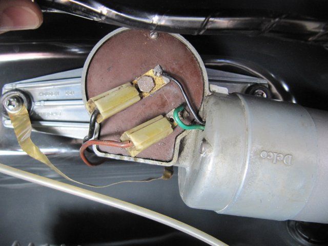

Looking at the manual on page 12-94 point number 17 it says "To adjust the parking position of the crank rotate the head of the hexagon pin as required using a 5/16 .in A.F. spanner, Fig 12F-11."
You can see the hexagon pin in the pic below.
Using some strips of masking tape as a guide we rotated the crank so the wipers moved up about 45 degrees. I think I turned the hex pin about 1 and a half turns approx. As you turn the crank you can watch the wiper pivot move into position. We turned the wipers on and viola! Success.
I think I must have spent about 3 hours trying to work it out... :oops: ...with the last 30 seonds of roatating the crank actually fixing the problem. :roll: :ebiggrin:
Anyway I learnt something new which is what it's all about. Thanks for your help too Pete. :thumbsup:
