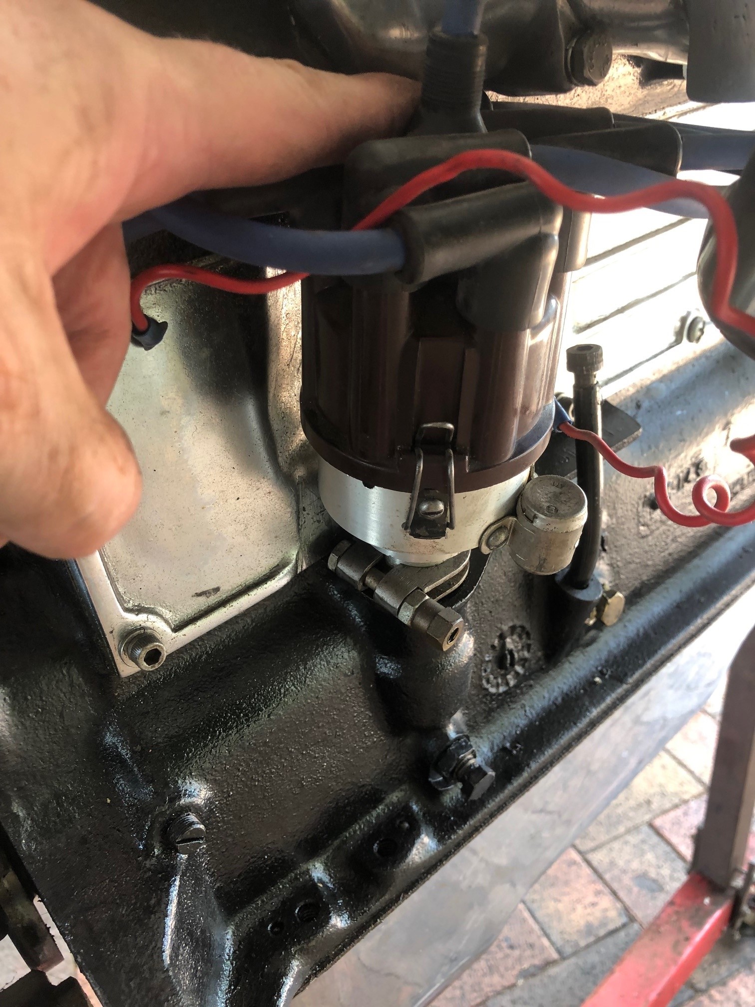

Posts: 4851
Re: Harv's Repco HighPower crossflow head thread
Santa came today 8)
Repco 1.jpg (1.19 MiB) Viewed 478 times
Repco 2.jpg (611.25 KiB) Viewed 478 times
Repco 3.jpg (652.38 KiB) Viewed 478 times
Repco 4.jpg (677.41 KiB) Viewed 478 times
Posts: 4851
Repco 5.jpg (915.99 KiB) Viewed 477 times
Repco 6.jpg (700.91 KiB) Viewed 477 times
Repco 7.jpg (896.03 KiB) Viewed 477 times
Posts: 11703
That’s purty 😎😎😎👍
When you're faced with an unpleasant task that you really don't want to do, sometimes you just have to dig deep down inside and somehow find the patience to wait for someone else to do it for you.
ardiesse
Posts: 1036
Post by ardiesse »
Are you selling tickets to the first startup with open exhausts?
Posts: 1800
Looks good Harv, can’t wait to hear it roar with those open pipes 👍
Posts: 9221
Being a tight arse myself, I'll just listen from the next suburb. Very exciting Harv. Tried setting the points yet?
