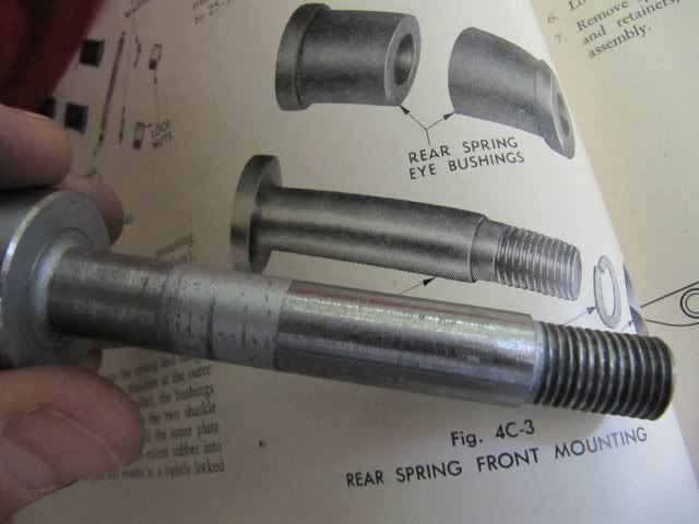

A test fit in 'reverse' - putting the head of the pin through first...there is no way it will going to fit...without shaving some metal off the head of the pin.

spot the difference...

No step in yours?

one is a drwaing, one is a real bolt :? :oops: :ewink: :ebiggrin: :lol:
It does have the step down just not as big as the pictured one. Although it looks like there is more thread.

You and a hundred others, Stewart....... we place our troth in replacement parts.... surely they know what they are doing...?
Sadly, a lot of this comes up....
Can you please tell us the difference in shaft boss length - if your issue is as a result of this, I would be making contact with the supplier.... - good faith, the onus is on them to rectify/correct supply.....

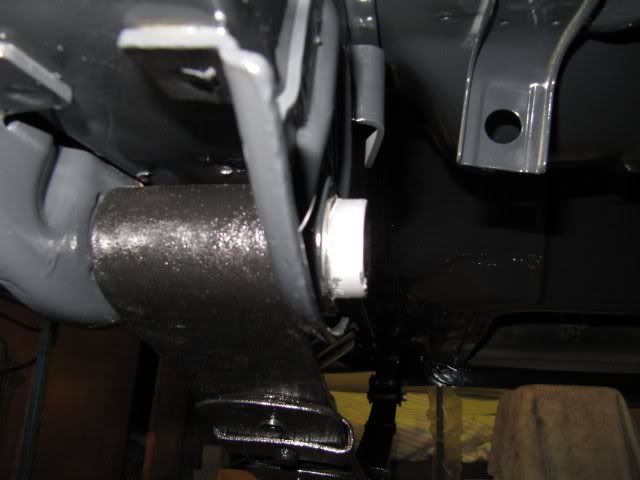

Oh, and by the way - what have I done to you...? your paintwork and attention to detail under there is magnificent....... tyre looks a little "ho-hum", however (sic).

There is slighly more thread (2-3mm) but the overall pin length is shorter. Just enough difference to make it a real pain to fit. I had to file down the shaft a bit. Got there in the end.
Roso - no sledge hammer... :shock: but a few good whacks with a hammer though. I'm really happy with the way the underside has turned out. I can't claim to laying down the paint that would be Dave (Bootlegger on the forum). No tyre under there yet - I think you can see an old towel draped over a stand of bricks.

Tyre would have been on the other side of the spring, and only a tyre-wall visible...
Releived to learn that you haven't widened your rear track...
