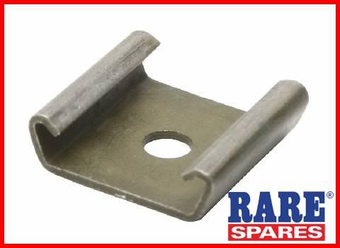

Hi everyone,
Trying to replace the clips to suit the stainless moulding that runs above the rear side cargo window for a wagon? These are available at Rares...they are actually moulding clip side moulds for a HR...
Part code: 7430602
regards
a picture of the clip location has been posted here by Finny http://www.fbekholden.com/forum/viewtopic.php?t=4938

Good find Stewart - saves a lot of grief...
One thing you may consider when you come to mount them, be careful with what you choose to screw them in with (if indeed, they are screwed....) - I have heard that iron and stainless do not make a good marriage - it is the iron which will become the anode.......
I used stainless self tappers when I made my clips - and sealed them out with butyl-mastic.
For the door/panel clips - I used hexagon shaped nylon retainers - purchased from Bill Thompson's ..... I screwed them in with stainless tappers and sealed the fit both sides of the tappers with butyl-mastic.
Sorry for stealing your thread....
Hi Rosco,
Thanks for those tips. I've read some of your other posts espousing butyl-mastic and was definitely going down that path.
regards
