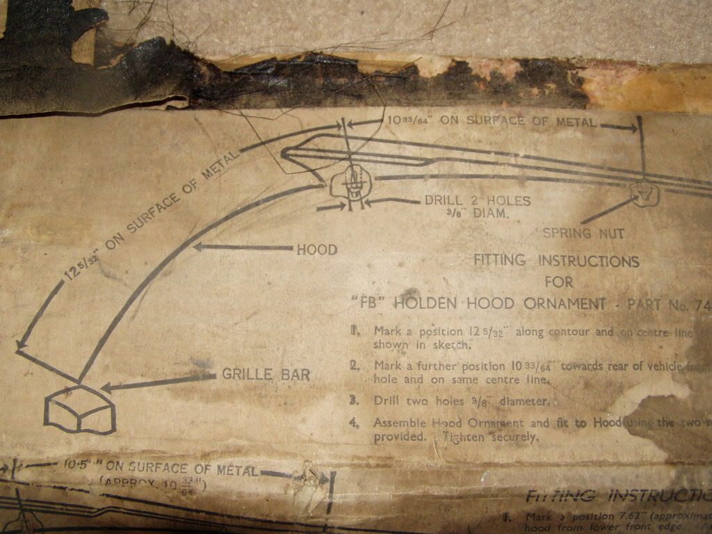

Just thought I'd throw this in for anyone interested.

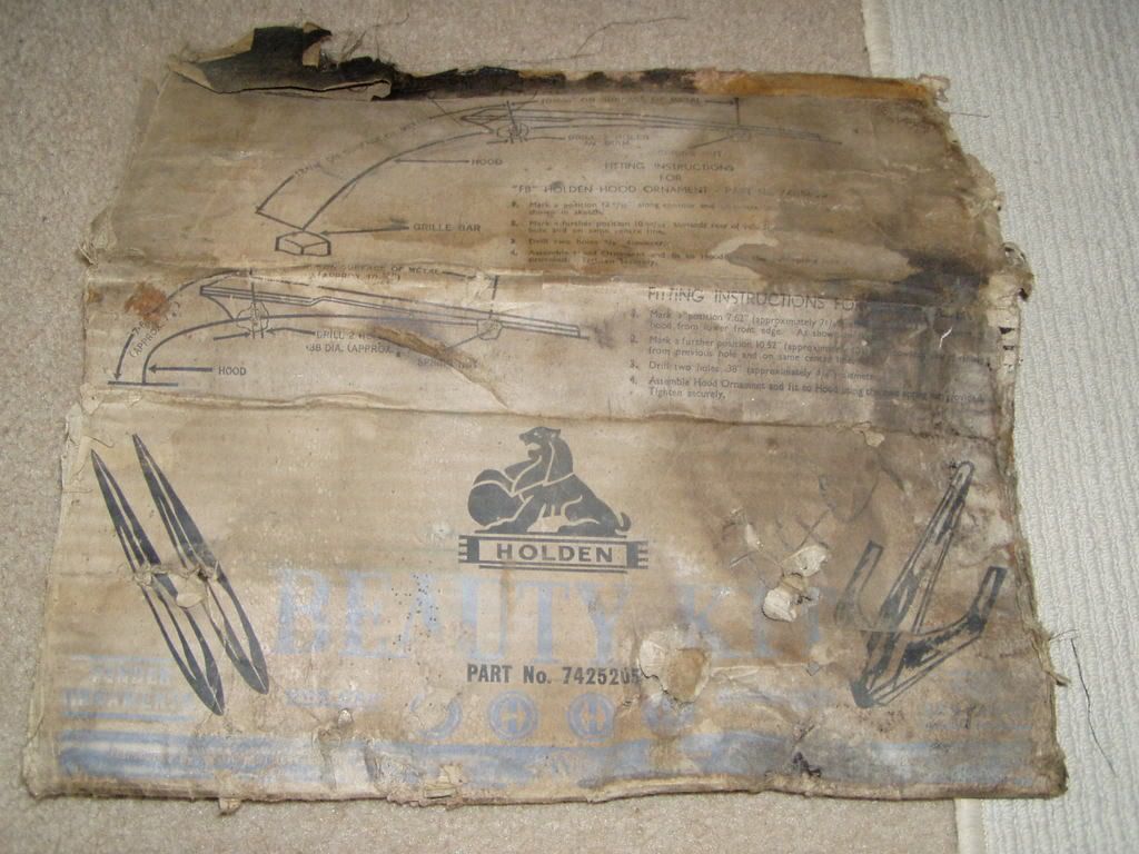

This i part of the NASCO 'Holden Beauty Kit' box the bonnet bird, fender ornaments and hub caps came in.
The photos show the correct measurements for installing the hood ornament....
