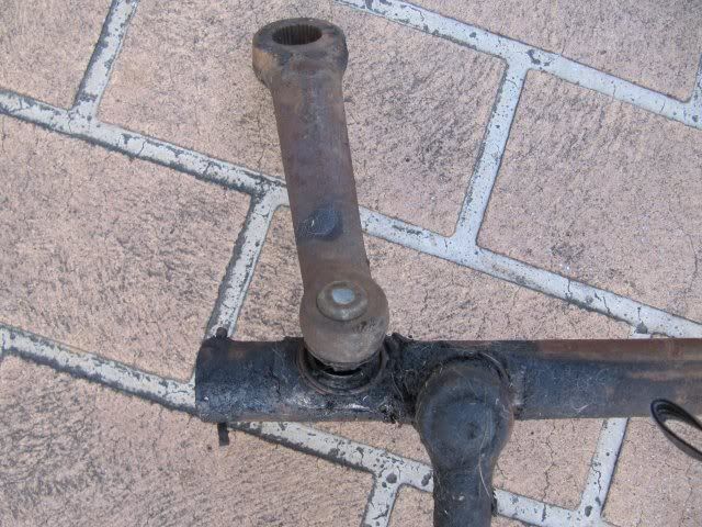

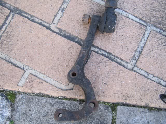

This is a really easy method of rust removal. I have used it a lot and it works very well. I'll try and post some before and after pics over the next few days.

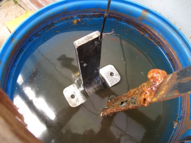

The part to be cleaned is connected to the battery charger negative. Battery charger positive is connected to a piece of steel about 3”x3” when using a 44 gallon drum. If using a steel containing make sure you line it with plastic. You virtually have to use a battery charger with an ammeter (or amps indicator) as the current flow is controlled mainly by the size of the piece of steel (positive electrode). The best method of controlling the battery charger is to initially leave the positive electrode out of the solution, turn the charger on, then carefully lower the positive electrode whilst watching the ammeter. When the ammeter shows a reasonable reading (to suit the rating of your charger) support the electrode to suit.
If you wish to clean only one or two small parts and elect to use a 2 gallon plastic garbage bin (9 litre bucket) a smaller piece of steel or large 3” nail would suffice for the positive electrode.
It is important that for both electrodes a good electrical connection is required. From time to time you will need to clean electrode connected to the battery charge positive. After a few uses it will probably need to be replaced.
Electrode Support
At least one of the electrodes should be supported from a piece of wood so that electrodes do not touch.

Parts can be left for 24 hours. Rusted areas converted by electrolysis will be black in colour. Rub down with wet and dry or wire brush. Parts will be now be very prone to rust again unless treated immediately, spray with WD-40 or paint parts.
