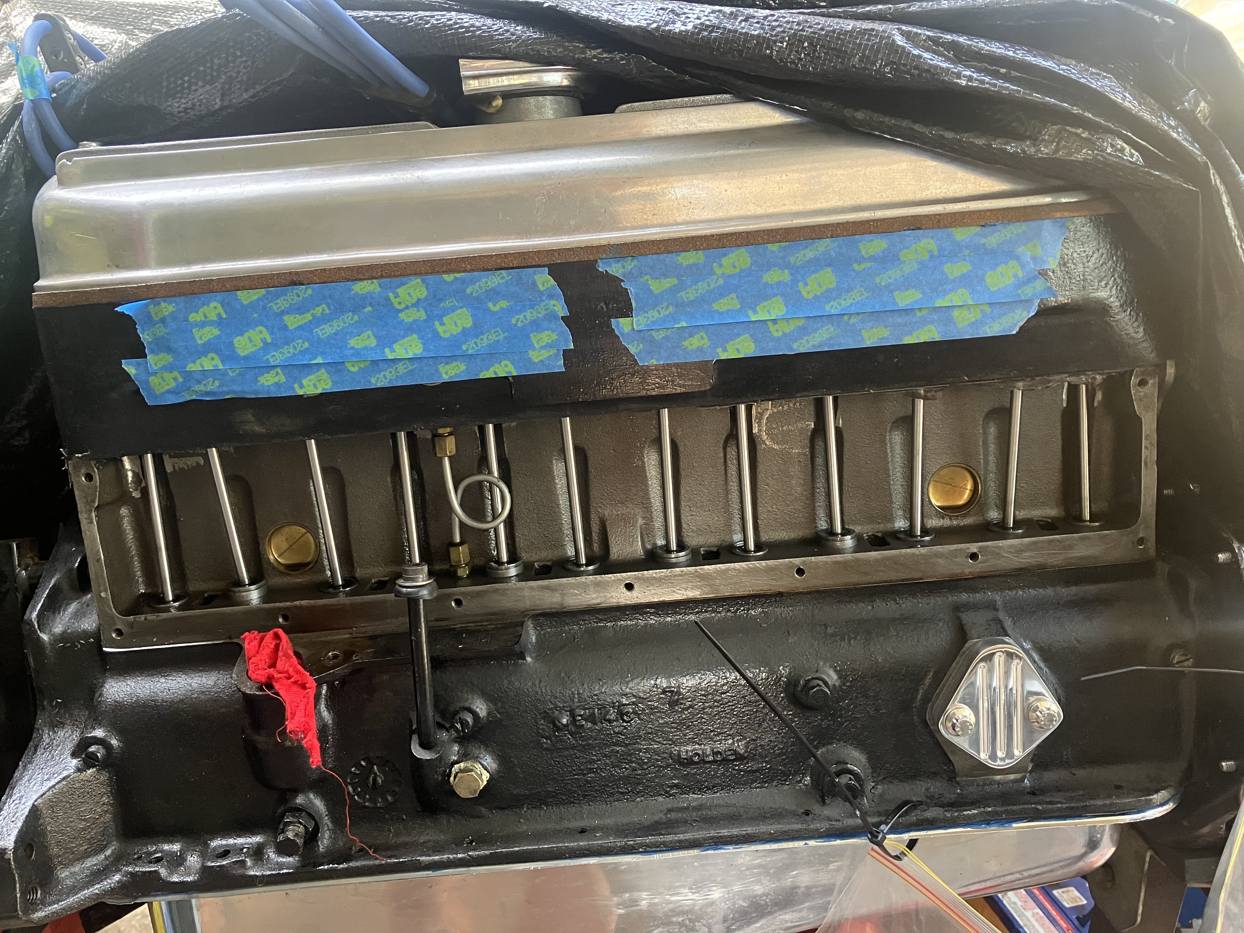

Side plate off, and as suspected I had dropped the breather baffle off inside the side cover.
One locknut, one plain. Can tell this thing was raced… no two fasteners the same.
