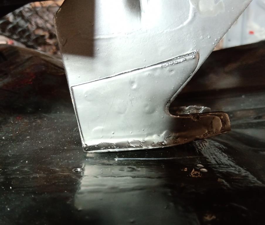

Ok, got the sliding mechanism working with the rod between driver and passenger side. The passenger side mechanism just needed a little lubrication and persuasion.
Bashed the floor around a bit where the front seat feet go and now have them pretty flat. Which brings me to the question of why are the front feet secured with a 'saddle'? Excuse my dodgy'd up one in the picture. Why not just weld a bracket to each side?

The front seat's front feet (like the sixth sheik's sick sheep) are secured by a saddle to make removing the front seat easier: four, easily accessible bolts at the rear, then you "just" unhook the front seat . . .
a doddle compared to removing EJ-HG front seats.

Thanks Rob, I thought as much. I guess the seats side trim piece gets in the way of undoing those front mounting bolts. Fair enough then. Someone on ebay wants $140 for a set of front saddle brackets and hardware - think I'll make my own!
