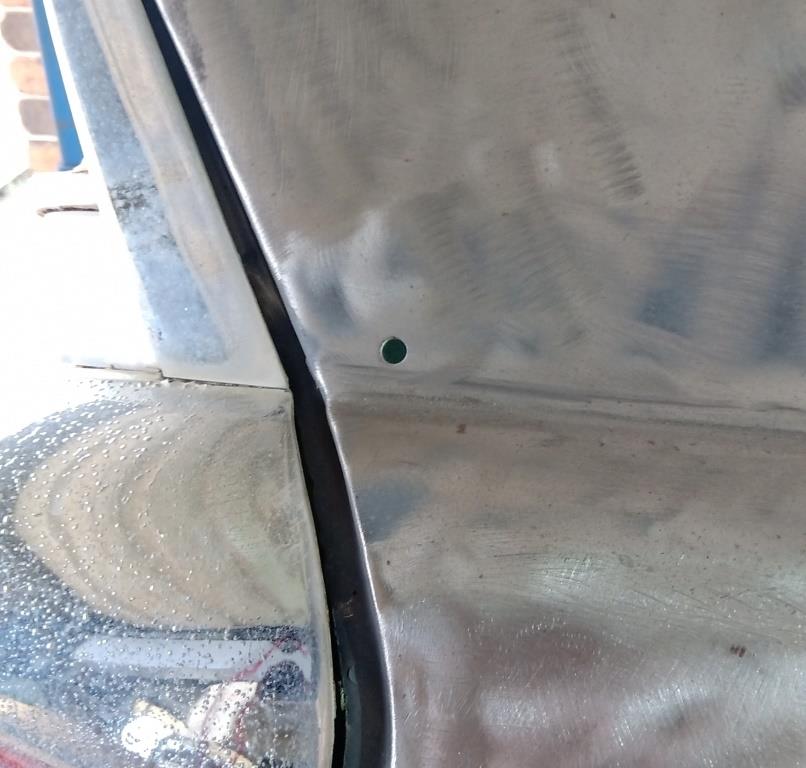

How is the rear taillamp unit supposed to interface with the rear qtr panel? It looks like I've got to straighten out the lumpy bits on the edge and cut a slit in it???

Rear lamp fits pretty well now
