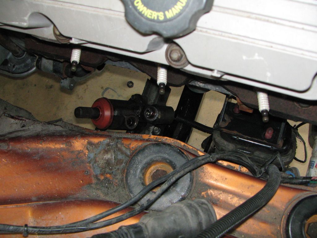

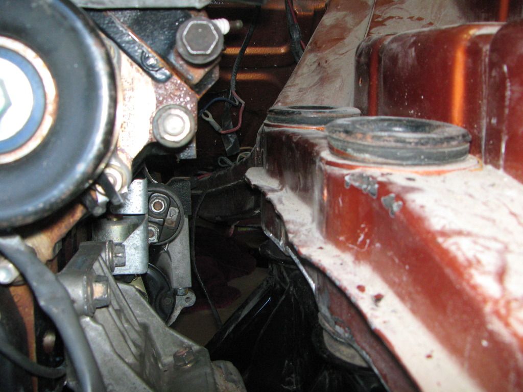

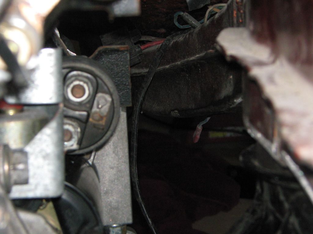

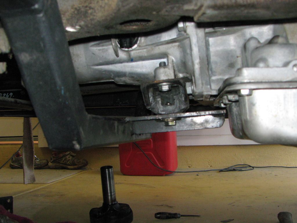

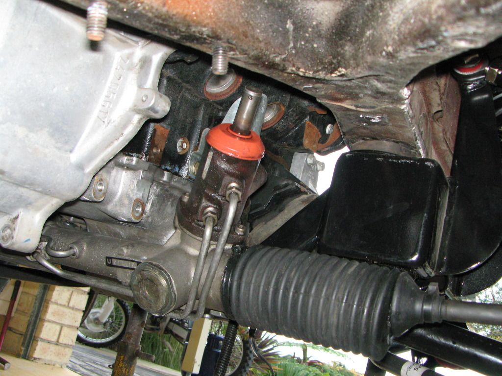

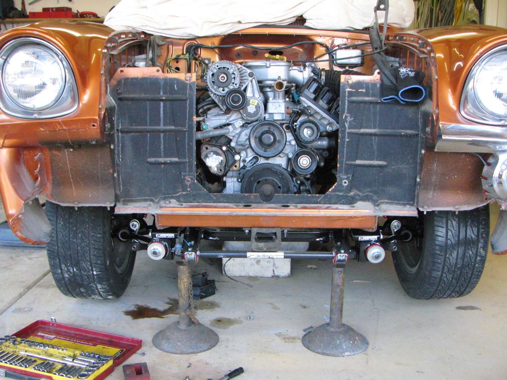

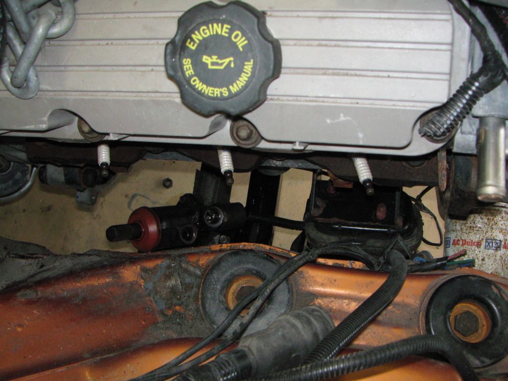

some more photo's on what fits and what does'nt fit
the air con does'nt fit, there's only about 2" of room & that's the biggest downer, i was just about to buy the Vintage air set-up
I kept my Extractors from CRS from when i had there HR front end but they don't fit on the drivers side, the power rack is in the way, i'll get Pats one
I kept the Gearbox Crossmember form CRS i had to elongate the bolt hole and cut some off for it to fit right, so thats right
i'll have to go with the new 7" power booster as there's not that much room for one
It does sit sit nice and i'm happy with it

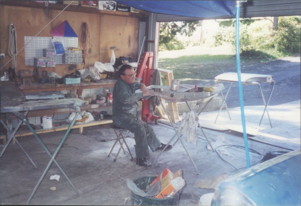

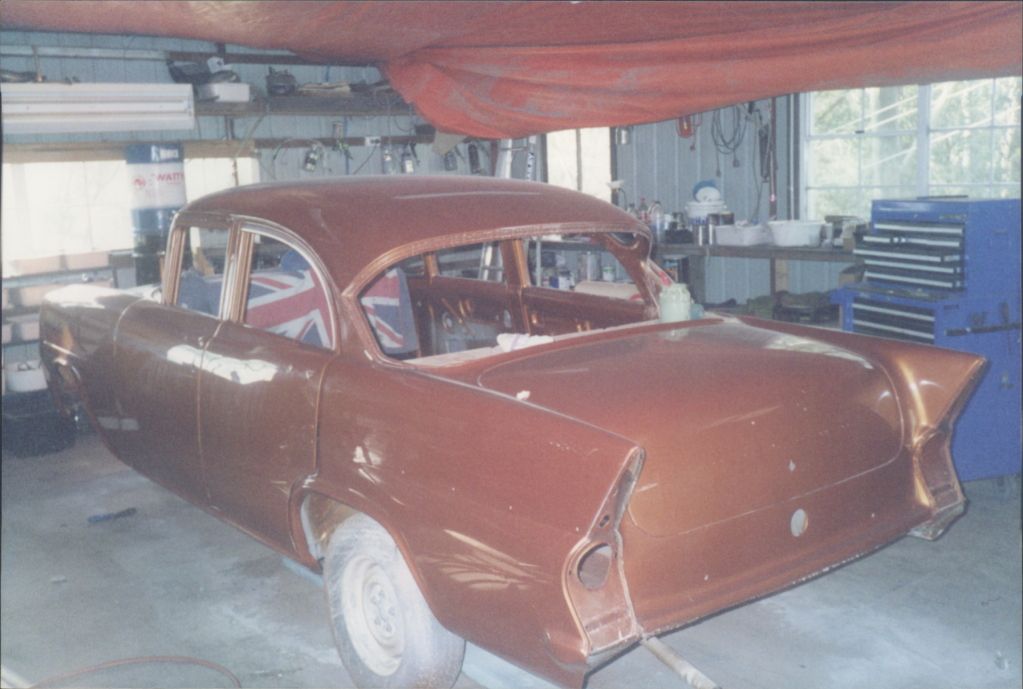

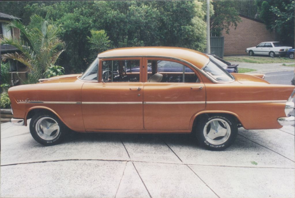

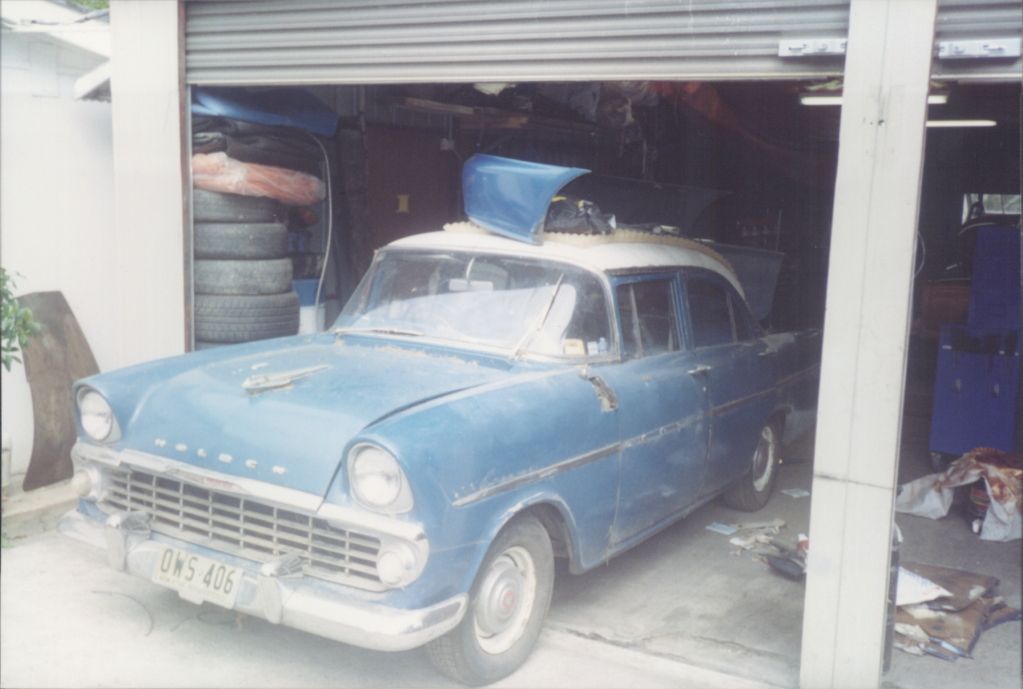

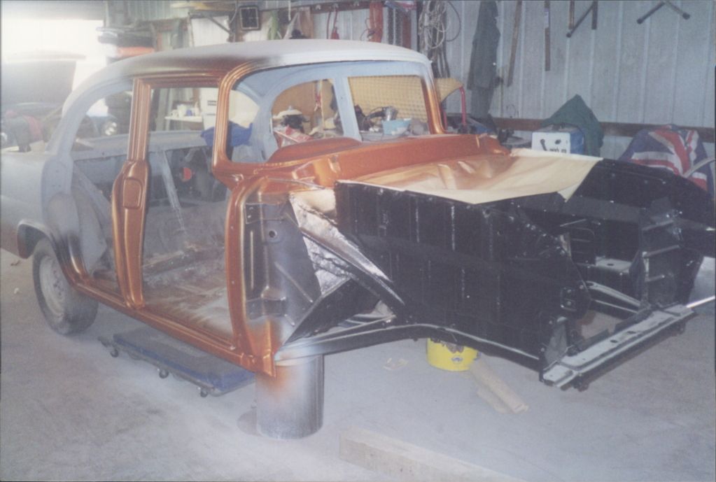

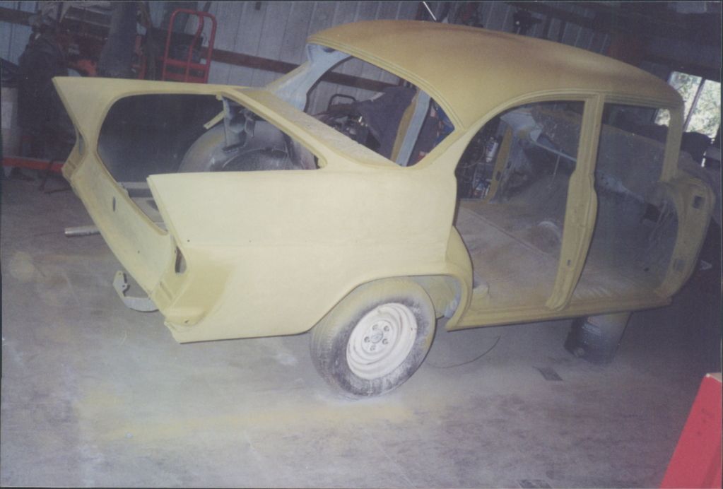

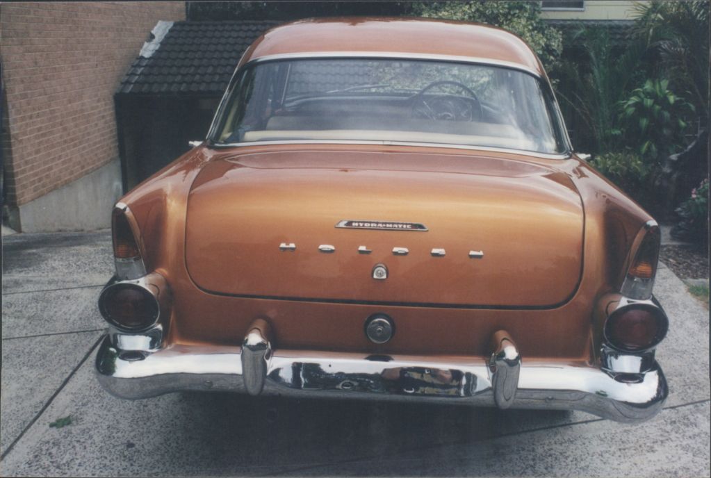

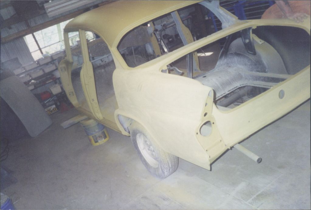

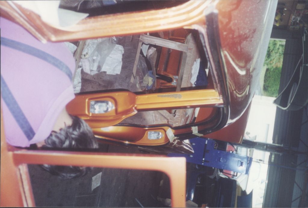

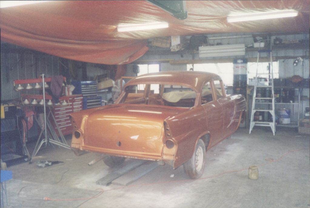

found some photos from when i was doing it up in 1999-2000
thats sid doing the crap jobs

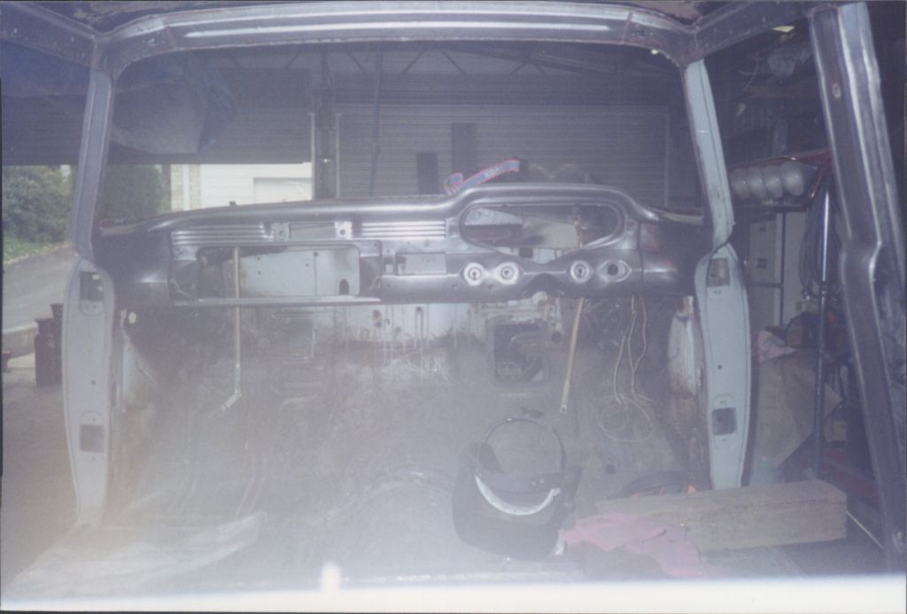

and the donor car

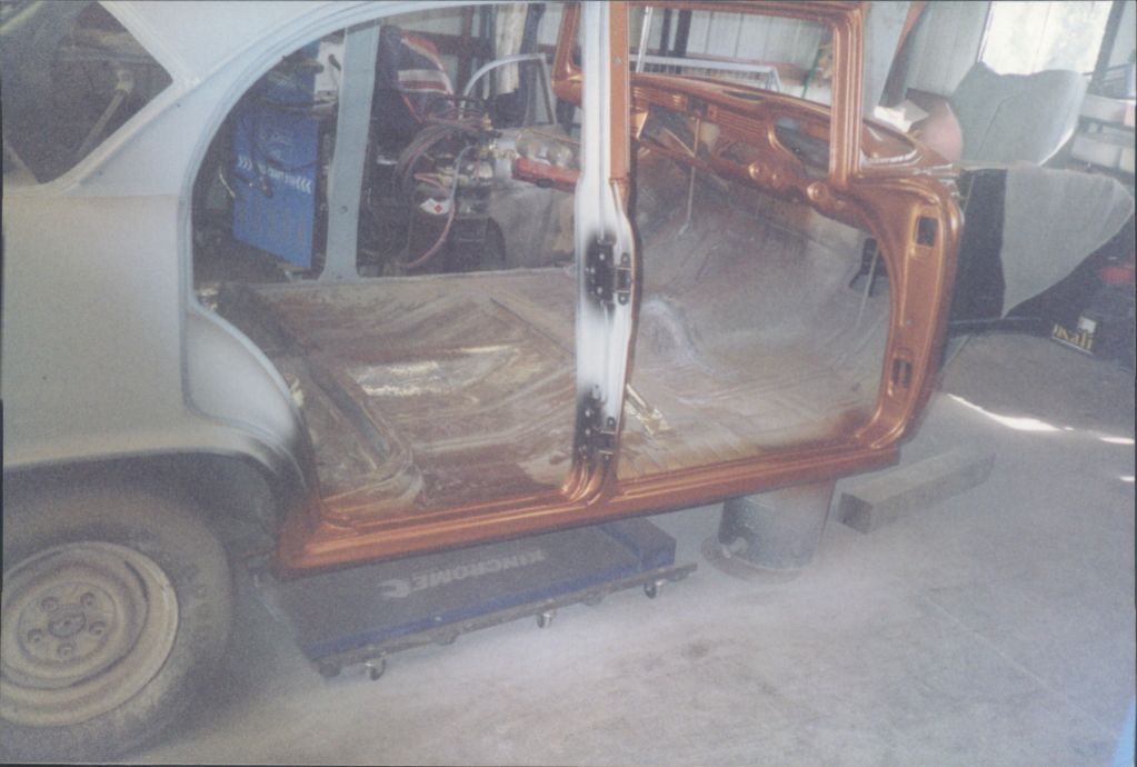

and some when it was finished ready for rego
and the donor car
Re: Tigers V6 Conversion
Looks cool as, nice job

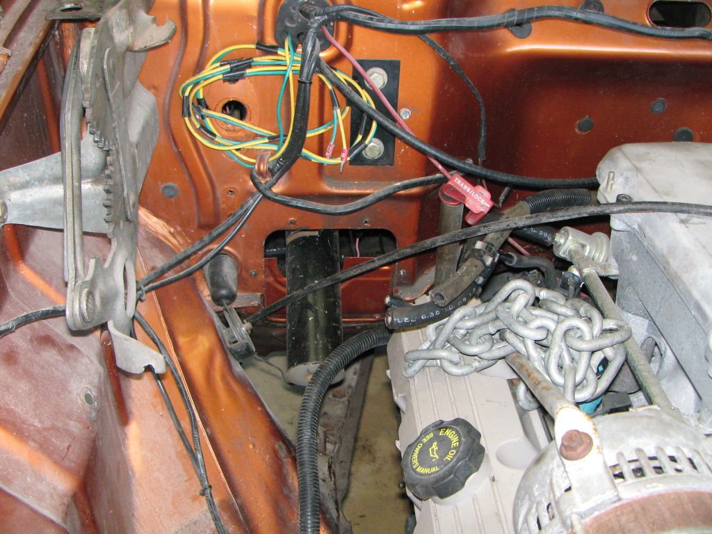

Well spoke to Pat about the air con and he has a bracket for it. (using a VS air con) that was good news, And i spoke with George (Alien retro columns) and he's starting to do the EK auto columns,I just have to work out the length,as with Pats front end the column stops at the fire wall,and a knuckle goes straight down to the rack,so the wire must start just inside the cab.so i have to check this out before i order one ( such fun ) here it is on his facebook page

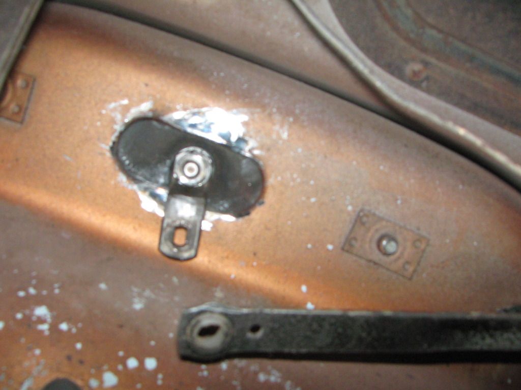

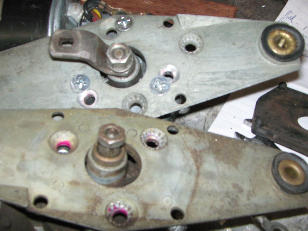

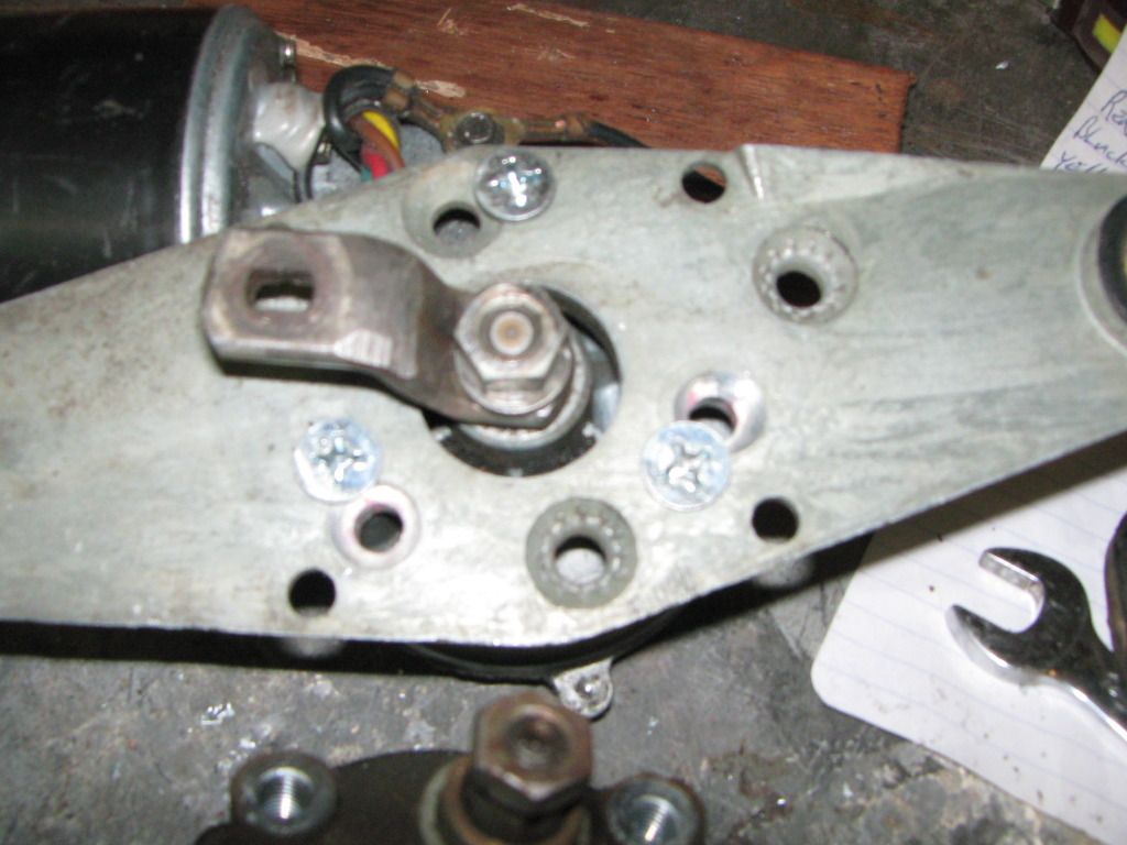

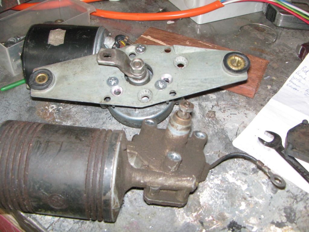

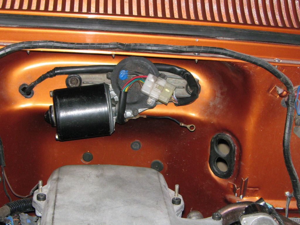

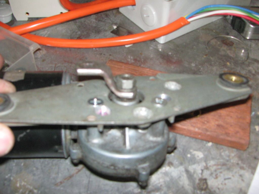

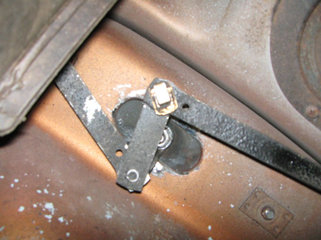

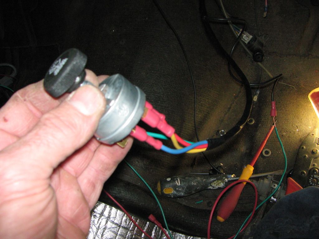

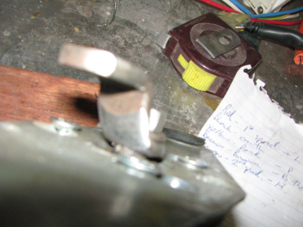

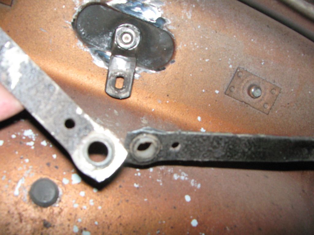

Well i finally got my wipers working,I had the wrong wiper motor that was the problem,so i got the right one
and this one fitted great
used my other plate to test it out with some new holes
had to grind a small bit as it was hitting the hole it sits in
and just put it back together
wireing was ease thanks to http://fefcholden.org.au/forum/index.php?topic=18113.0
and all is fine
and all is fine
